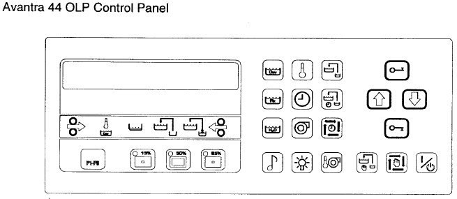

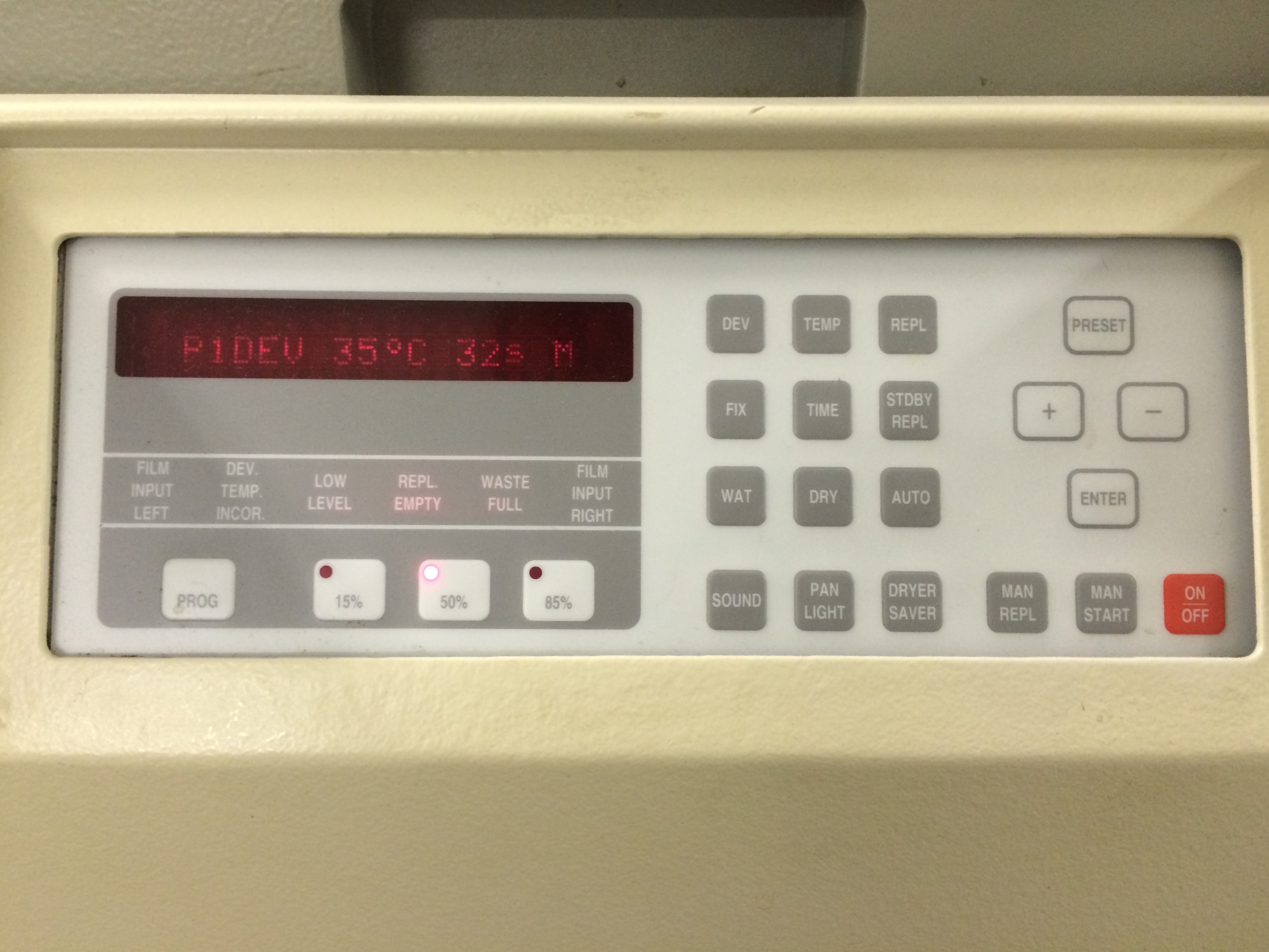

We have experienced about 6 part failures in the past 3 years, and 8 in the past 5 years, on two different Avantra 44 OLP (online film processors): Some Buttons just stop working. This is a very expensive membrane switch, and we can not afford to keep giving several hundred dollars to AGFA every few months because one or two critical buttons stop working. I've never had the entire panel go dead, but have had additional buttons continue to fail until nearly every button was unresponsive. I have seen several stop working on the same day.
Once a button stops working, it never works again, or even intermittently. Dead forever. When you push it, it feels normal, makes a little "click" feel and sound BUT no response.
1) Is there any way to repair these?
2) IS THERE ANY WAY to plug the cable that goes to this panel INTO A LAPTOP/DESKTOP COMPUTER, and use some type of command line or rudimentary interface to interact with and control this film processor's controller/computer? BYPASS/ELIMINATE THE MEMBRANE CONTROL PANEL?
3)Anything that can be done before installation or during use to prevent failure, and extend service life?
4)Are there any other suppliers/manufacturers than AGFA who make a more reliable panel?

The keypad is laid out in a grid pattern of rows and columns. Quite often if a key is bad then all keys in that row or column will be bad also. In that case there is no choice except to replace the keypad. If a key is bad and other bad keys aren't in the same row or column (as you look at the keypad) you can try this. Cut the top off of the key and short the metal contacts that are exposed with a nail head or some such. Sometimes this works and sometimes not, but it is already not working, so nothing ventured nothing gained. G&J is the only vendor for this keypad. I've checked with other manufacturers of keypads and they can duplicate it with a minimum order of 20 priced at $250 each for a total of $5,000. Not a viable option IMHO.
Consider setting the machine so very little, if any, use of the keys are necessary. The On/Off can be programmed to automatically turn on at a specific time and off at a specific time on specified days. Do you have the manual so you can configure for this? Manual Start I only use if there is an existing problem with jams. Fix the jam problem. Manual Replenish, is there a leak that needs fixing or is there a copy density issue? Correct setup for processing replenishment and standby replenishment will fix density issue but not a leak. Program key is used to select different setups for temp, speed and replenish rates. Unless you have issues with different vendors for film or chemistry, from time to time, this is an unneeded key. That is as long as temp, speed and replenish rates are properly set.
