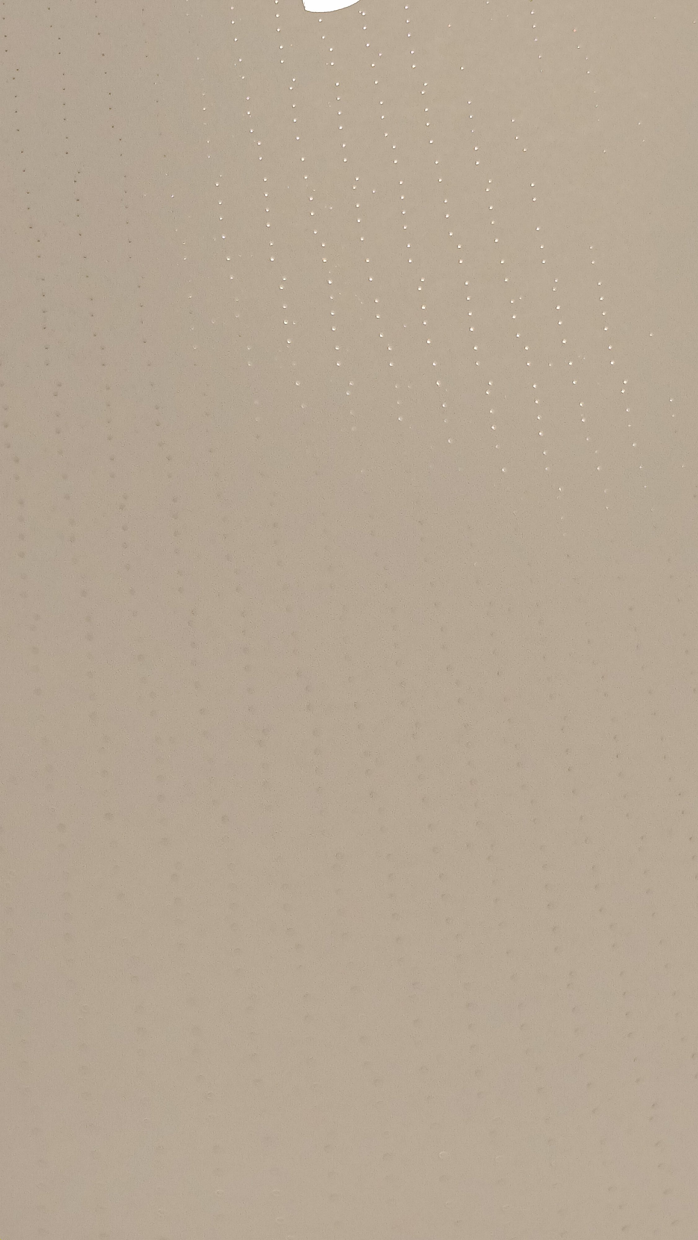

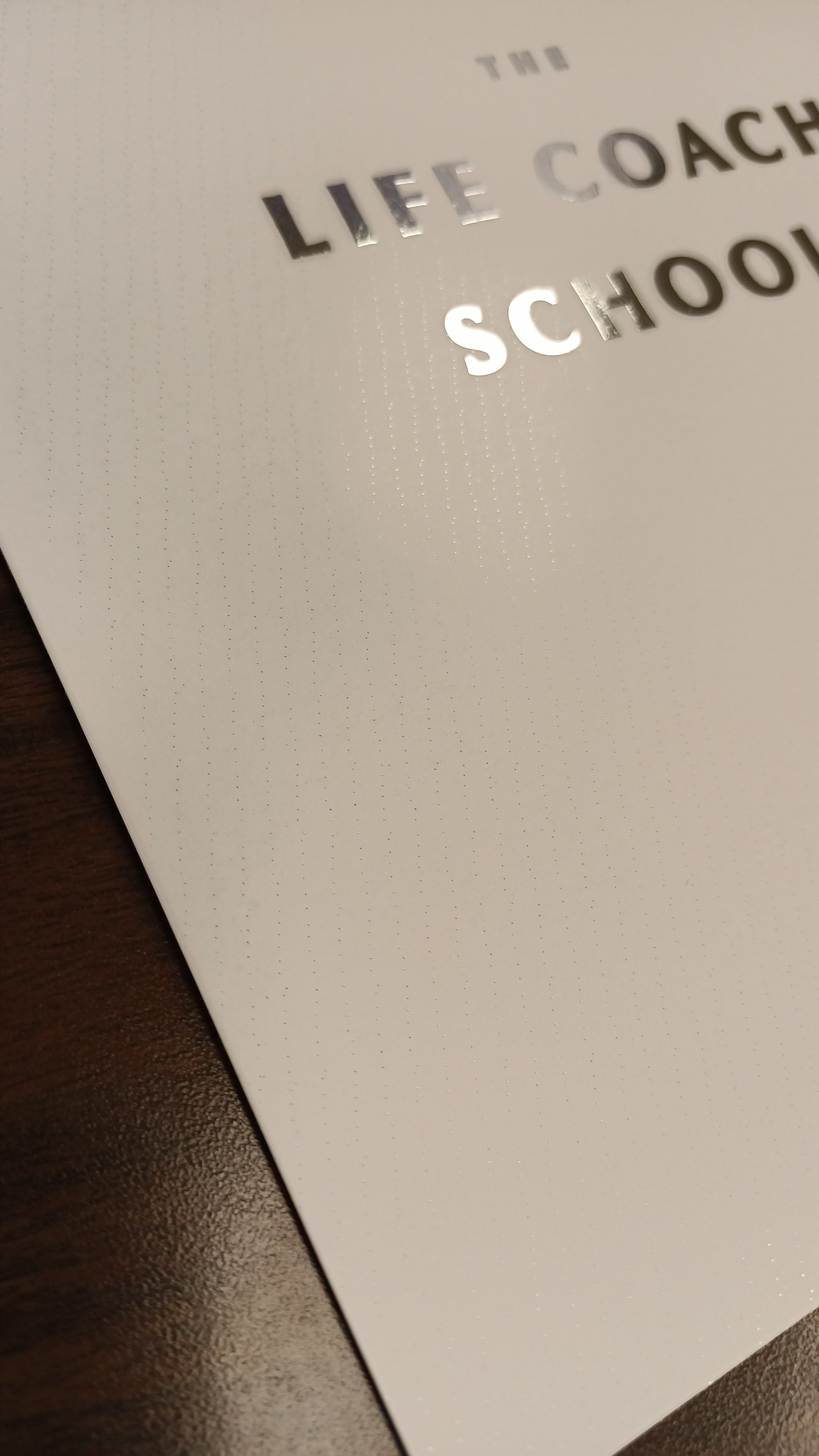

Our problem was foiling. Foil sticks to the tiny dots too. Looks all sparkly across the page. .

Holy smokes you weren't kidding!!! I always assumed the tracking dots were sparsely applied, never considered that they'd cover the entire sheet like that.
Does this happen only on white print? I'm not super familiar with that model printer, but I would definitely try test prints with the "Print white only", "Adjust for gray paper", "Adjust for white paper" etc settings and see if you can recreate the issue or isolate it to a particular mode.

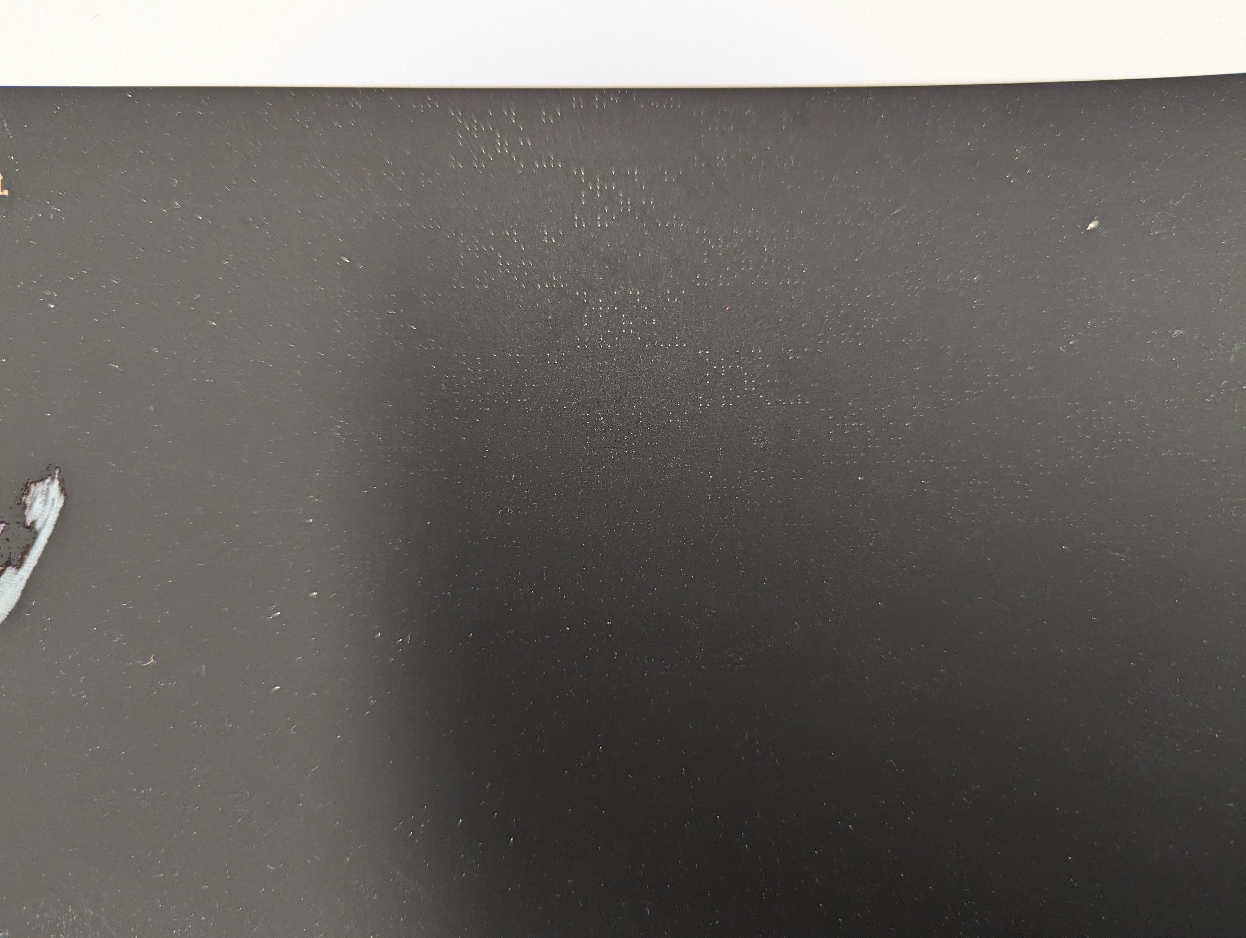

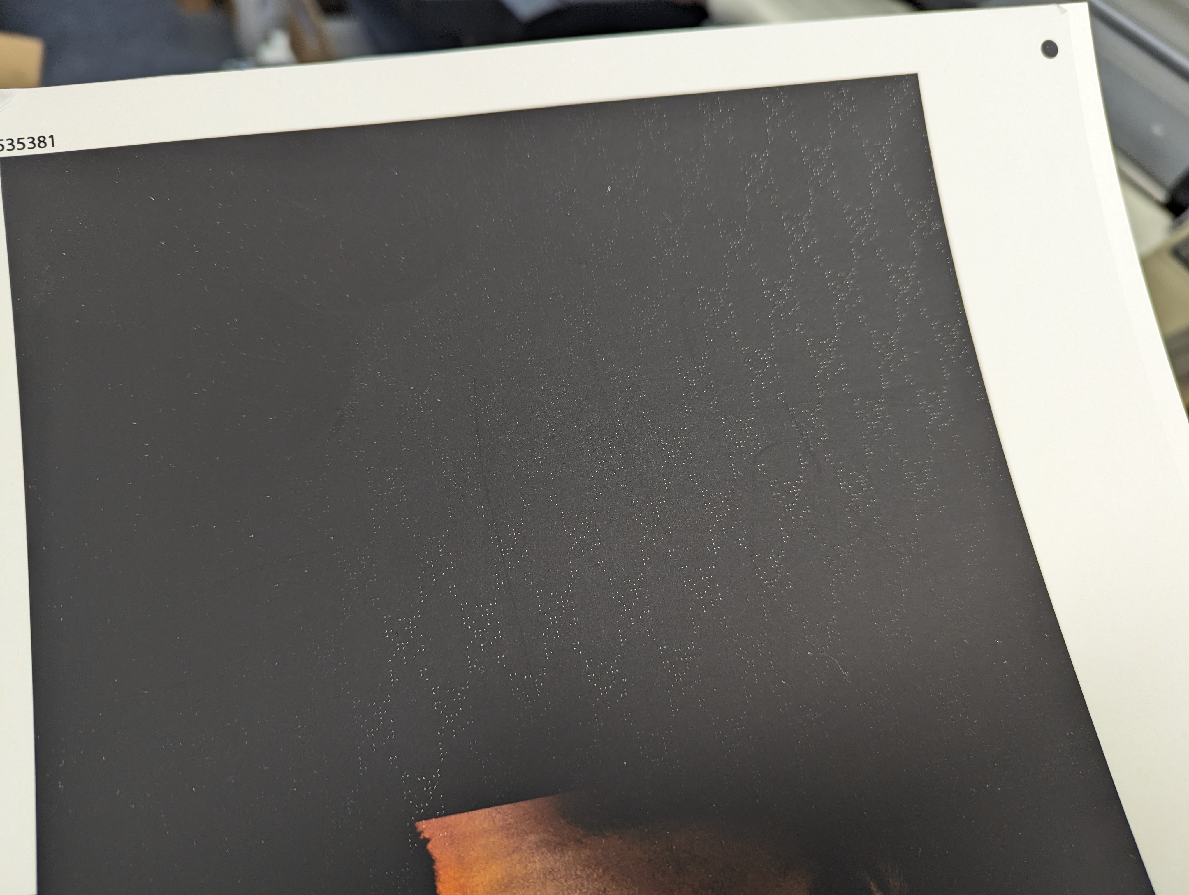

tbh im fine with foiling in most instances as i use full 100% k which doesnt introduce them, the issue starts when im trying to clear gloss lam by overprinting in colour. ill send a pic!
Check this out!!

Doesn't happen with 100% W or K just CM or Y for me! kind of makes the point in a white toner printer redundant it really does!.

Print CMYK to a board - Lam in soft touch or anti scratch - Run through the printer again for the areas i want to gloss - lamination machine for the clear gloss laminate
I think he's referring to a type of "foiling" Looks like lamination, but it lays down a shiny gloss that sticks to toner only. Just like foil. But clear, and shiny.
